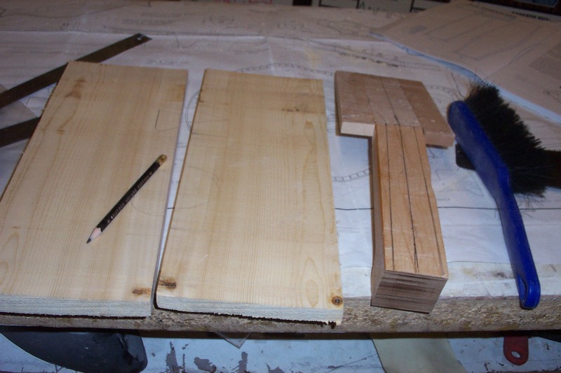

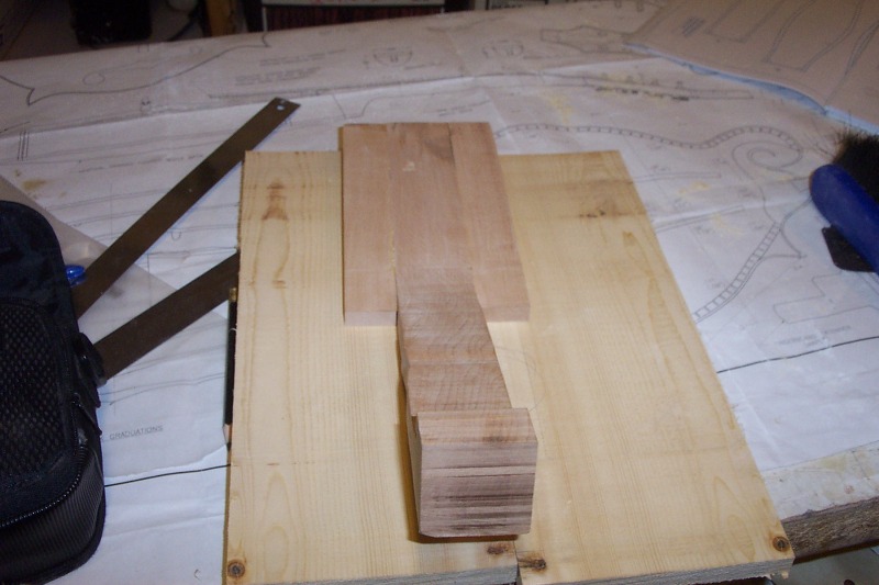

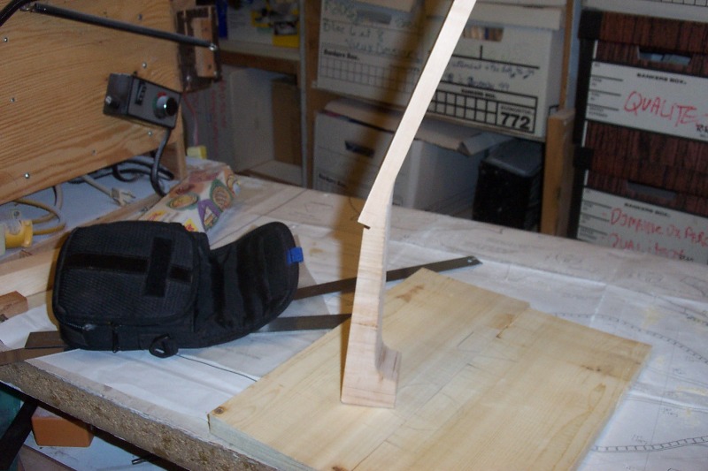

Here it goes, started by preparing the neck, glued the peghead ears and resawn(sp?) a plank of spruce i bought locally for practice before i work with Shane's Lutz
I was surprised to see tight grain in a plank from the local home store

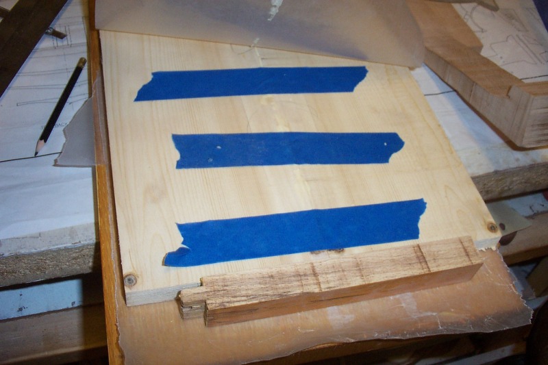

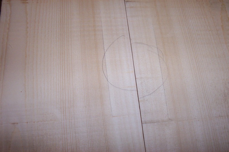

Glue up of the spruce plates

Nice bit o' spruce there..you were very lucky to get such a nice peice of wood from a local DIY store...
I had a hunt yesterday at my local store and it's horrifying to see what quality of wood is for sale...
PostPosted: Sat Oct 07, 2006 7:41 pm
Thanks Sam, yes i was and it taps nicely too!
Yes, seems like the quality isn't always there nowadays
